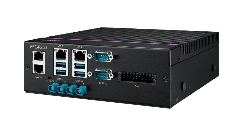

Step 1: Power Off and Connect
  1. Shutdown Jetson device first
  2. Connect USB Type-A to Type-C cable from Host to its FLASH port

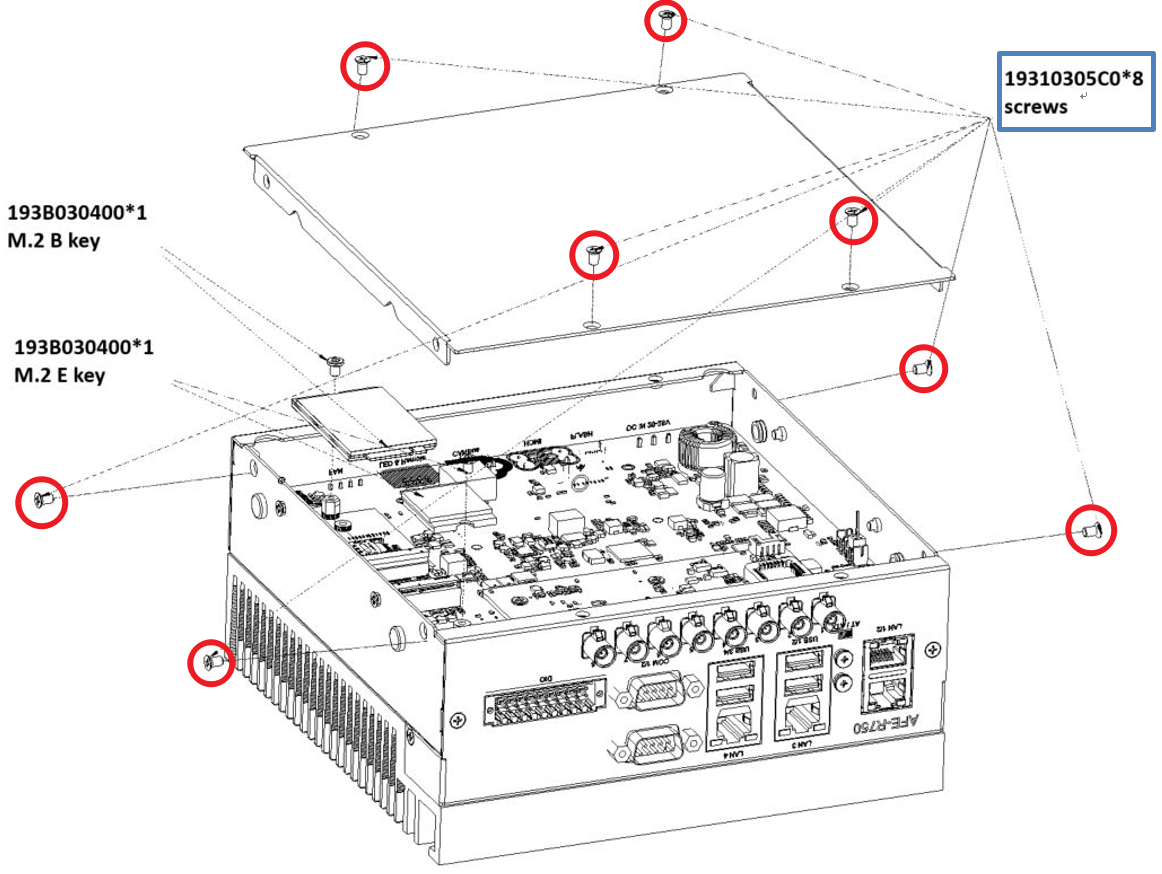

Step 2: Open Bottom Cover
Open the bottom cover of AFE-R750 to access recovery pins.
Bottom Cover

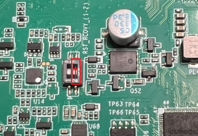

Step 3: Configure Recovery Pins
  1. Set the RST_RCOVY pin 2 to ON position
  2. Press the power button
  3. AFE-R750 will boot into recovery mode
Recovery Mode Setup
