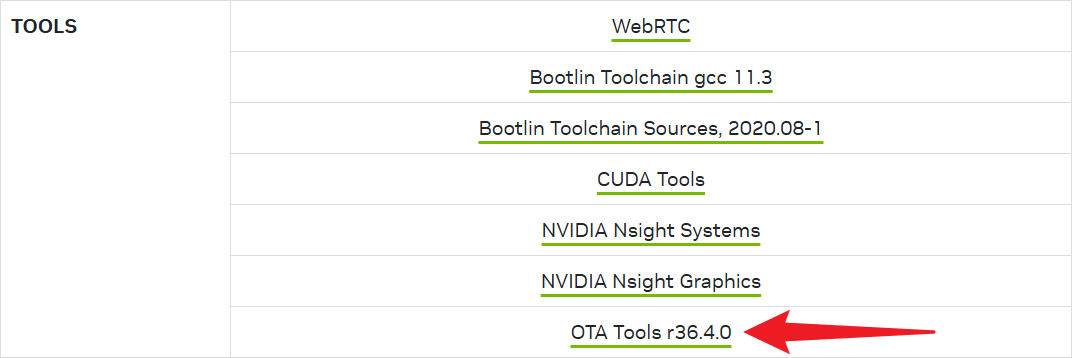

Step 1: Download OTA Tool
Download OTA tool from NVIDIA based on target JetPack version (e.g., JetPack 6.1 = r36.4.0).
Download Link
OTA Tool Download

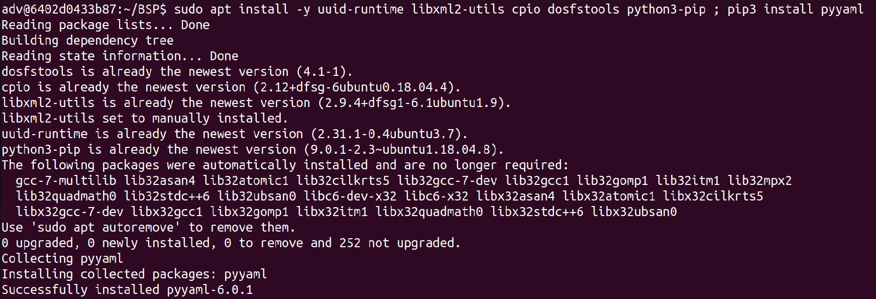

Step 3: Install Dependencies in Container
In order to build OTA package, container has to install some dependences by apt command.
sudo apt update
sudo apt install -y uuid-runtime libxml2-utils cpio dosfstools python3-pip
pip3 install pyyaml

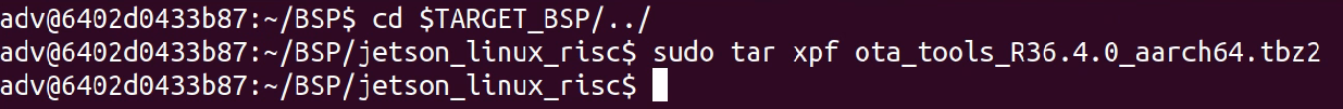

Step 5: Setup OTA Tool
Put the OTA tool into $TARGET_BSP/../ which should be /home/adv/BSP/jetson_linux_risc/ and extract the OTA tool.
cd $TARGET_BSP/../
sudo tar xpf ota_tools_R36.4.0_aarch64.tbz2
OTA Tool Setup

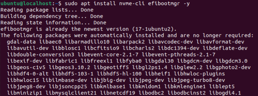

In order to do OTA update, AFE-R750 has to install two dependences by apt command.
sudo apt update
sudo apt install -y efibootmgr nvme-cli
Install on Jetson

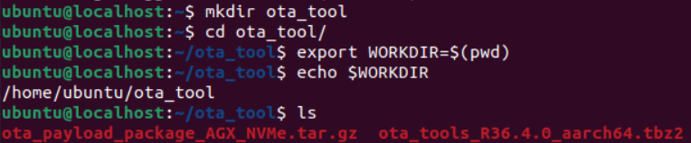

Setup WORKDIR
Create a ota_tool folder and put OTA tool and OTA image inside. Set the ota_tool absolute path as WORKDIR.
mkdir -p /home/ubuntu/ota_tool
export WORKDIR=/home/ubuntu/ota_tool
Work Directory

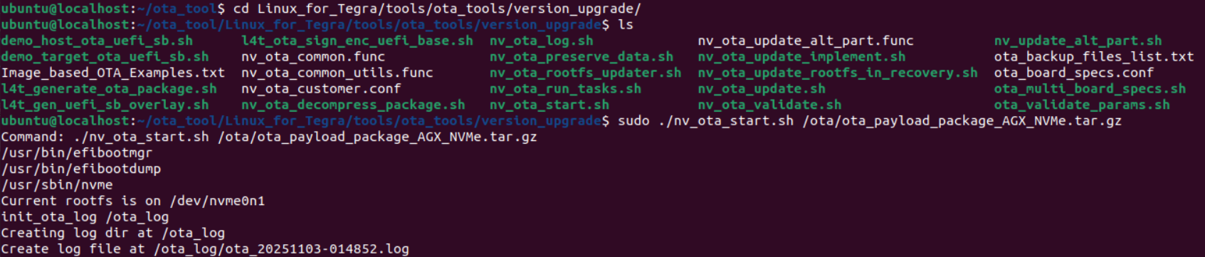

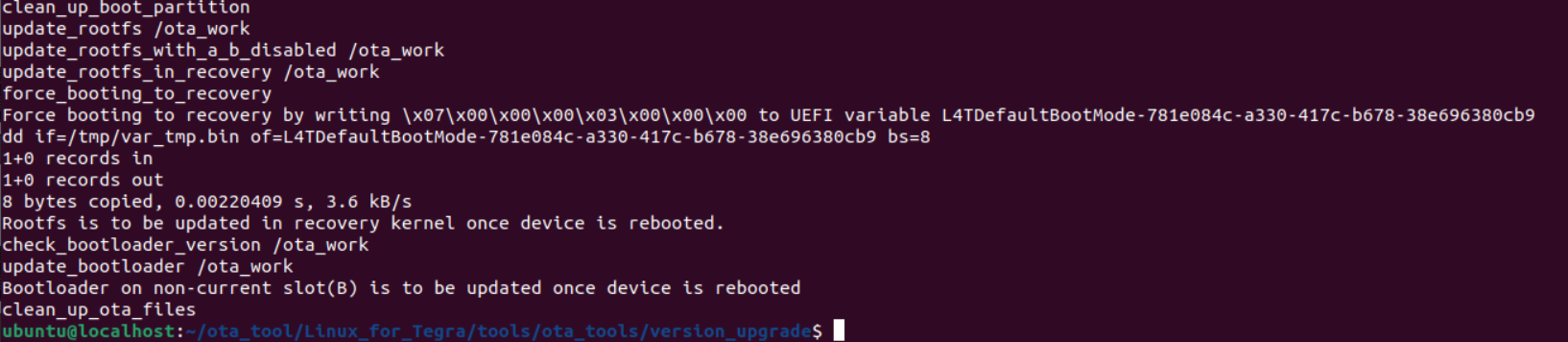

Step 8: Trigger OTA Update
From WORKDIR go to OTA trigger script folder and Trigger the OTA update.
cd Linux_for_Tegra/tools/ota_tools/version_upgrade
sudo ./nv_ota_start.sh /ota/<your_ota_package.tar.gz>
Trigger OTA
Step 9: Complete Update
After trigger finishes, reboot the system.
sudo reboot

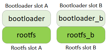

Integration with Redundancy
  • If a Jetson device flash with redundancy function and currently boot up into slot A.
  • Once OTA update is triggered, the slot B will be re-flash. Which means, if user want to re-flash or upgrade slot A, please switch to slot B first.
OTA with Redundancy
