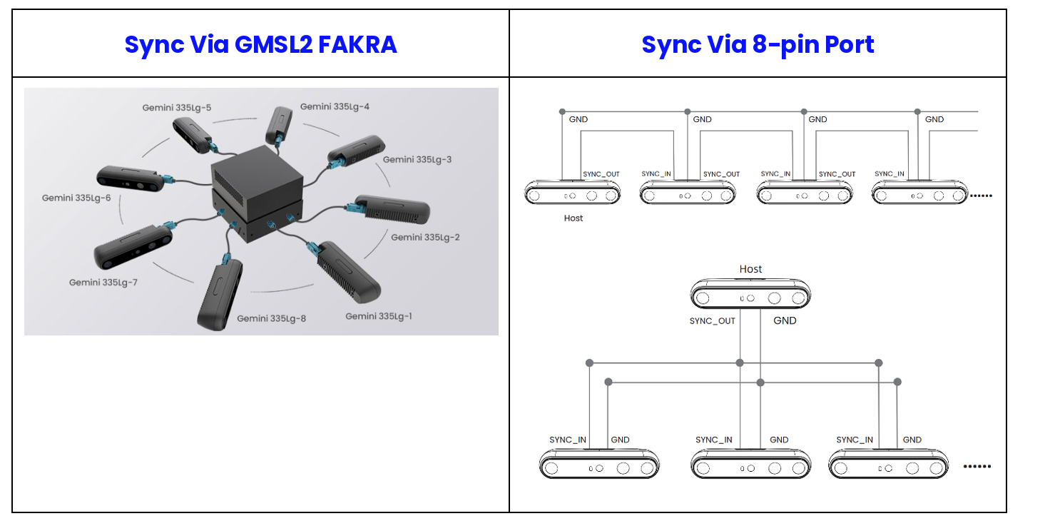

The platform currently supports two synchronization methods.

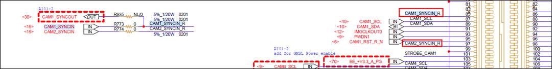

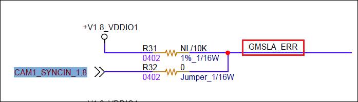

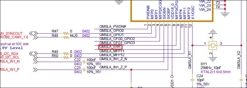

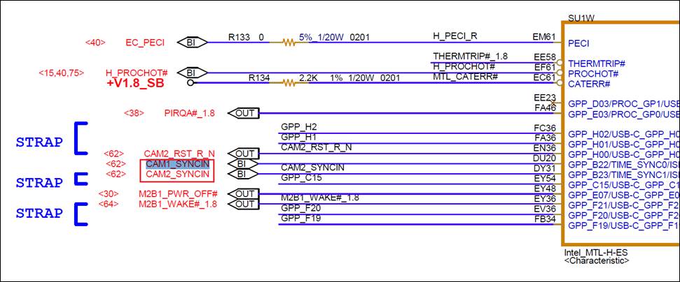

TGPIO Hardware Routing​
Verify that the CPU TGPIO signal is correctly connected to the GMSL deserializer.
The following example uses the ASR-A502 platform.

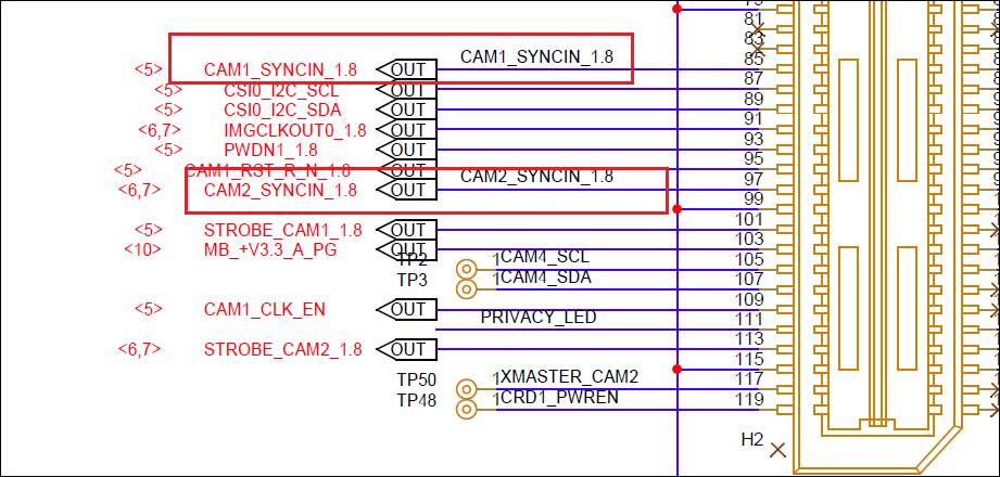

CPU to 120-pin Connector​
Time comparison output PPS signal waveform

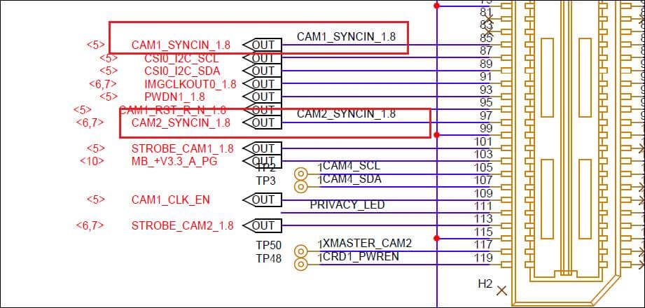

120-pin Connector to MAX9296A (GMSL Daughter Board)​

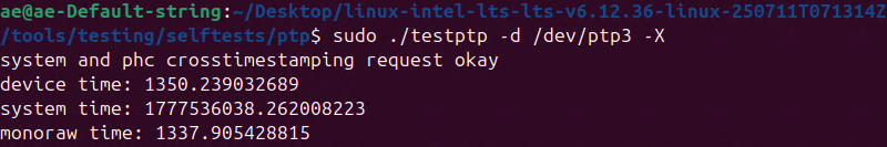

Time Offset Measurement
Compare the TGPIO PTP hardware clock with Linux CLOCK_REALTIME to calculate the synchronization offset.
sudo ./testptp -d /dev/ptp3 -X

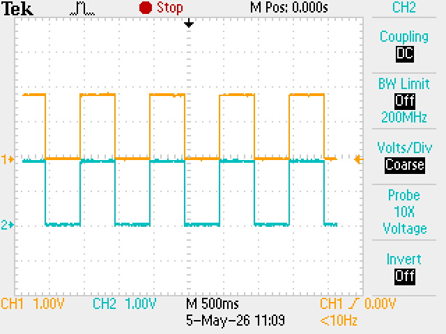

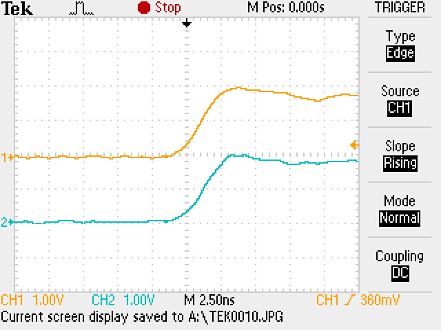

PPS Signal Generation
For hardware validation, testptp can generate a PPS waveform through TGPIO output pins.
The PPS signal should be verified using an oscilloscope.
The ASR-A502 GMSL daughter board includes two deserializer ICs.
TIME_SYNC_0 → PPS Output​
Example using /dev/ptp3:
sudo ./testptp -d /dev/ptp3 -i 0 -L 0,2 -p 1000000000
  • 1000000000 represents a 1-second cycle period
  • Output waveform:
    • 50% high level
    • 50% low level
  • The generated PPS signal is not phase-aligned with Linux system time
TIME_SYNC_1 → PPS Output​
sudo ./testptp -d /dev/ptp3 -i 1 -L 1,2 -p 1000000000

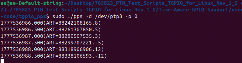

Continuous Synchronization Service
Over long operating durations, drift between Linux system time and the TGPIO PTP hardware clock may gradually increase.
For robotics and AMR applications requiring stable long-term synchronization, a continuous calibration mechanism is strongly recommended.
Intel provides a reference implementation:
RDC#785823
Precision Time Measurement Test Scripts and Timed-GPIO for Linux*
https://cdrdv2.intel.com/v1/dl/getContent/785823?explicitVersion=true
The package includes a sample utility, pps, which continuously aligns the PPS signal with Linux system time while controlling TGPIO output.
Source location:
785823_PTM_Test_Scripts_TGPIO_for_Linux_Rev_1_0/
└── Time-Aware-GPIO-Support/
└── user-code/
└── tgpio_pps/
└── pps.c
Before compiling pps.c, retrieve the TSC/clock ratio and nominal core crystal clock frequency using the following command:
cpuid -1 | grep -E "(Time Stamp|TSC/clock|nominal)"
Continuous synchronization flow
Modify the required definitions inside pps.c, then rebuild the utility.
Continuous synchronization flow Continuous synchronization flow
For TIME_SYNC_0 PPS output:
sudo ./pps -d /dev/ptp1 -p 0
This service continuously aligns the generated PPS signal with Linux system time.
