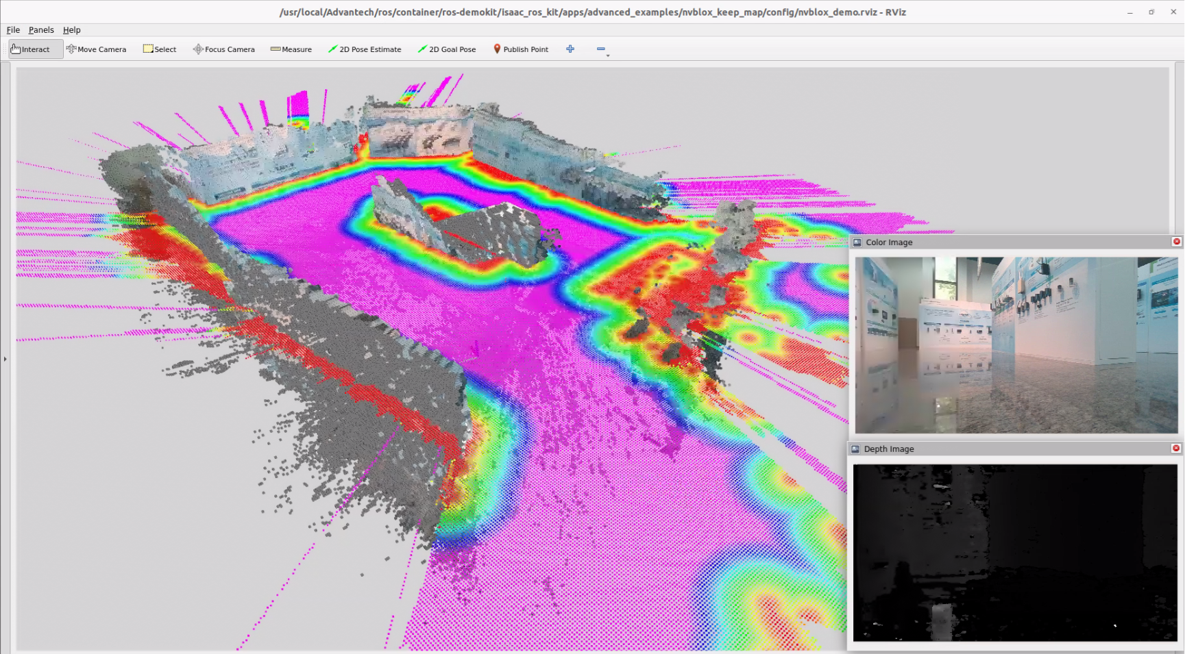

This blueprint focuses on demonstrating how to quickly adjust ISAAC Nvblox parameters to preserve visualization data and make the 3D scene “persistent” instead of slowly fading away.

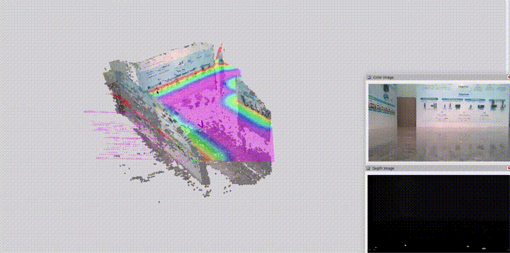

Under the default parameter settings, the map is continuously decayed and pruned to save memory and keep only the nearby, recent data. This is usually desirable for mobile robots, but it means that:
  • Surfaces you saw a while ago will gradually disappear
  • Voxels that are far away from the robot will be cleared
  • The 3D scene will not remain stable in RViz
To achieve 3D scene persistence, we explicitly disable these “forgetting” behaviors.

    decay_tsdf_rate_hz:=0.0
    • Disables temporal decay of the TSDF layer.
    • Surfaces you scanned earlier will stay in the map and remain visible in RViz as long as the node is running.

    clear_map_outside_radius_rate_hz:=0.0
    • Disables the periodic clearing of voxels outside the radius.
    • 3D data that you have scanned will not be removed even after the robot moves away.
tip
In summary, setting both parameters to 0.0 tells Nvblox:
"Do not decay old TSDF values and do not clear the map based on distance."
This is what makes the 3D scene appear persistent.
When to use scene persistence​
Use the configuration from this blueprint when you:
  • Want to record and visualize a stable 3D reconstruction for demos or testing
  • Need to compare before/after parameter changes without worrying about the map disappearing
  • Are building tools that require a persistent 3D context, such as inspection or mapping GUIs
