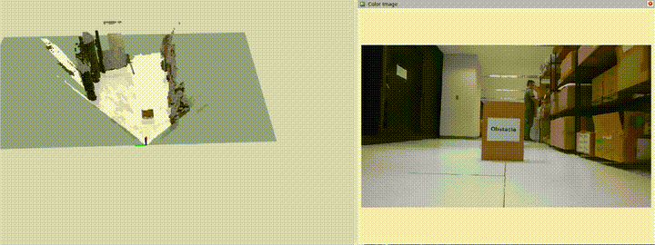

  • The 3D Camera Obstacle Avoidance will be displayed automatically:

  • Observe the visualized workflow of Nvblox integrated with Nav2 for navigation and obstacle avoidance

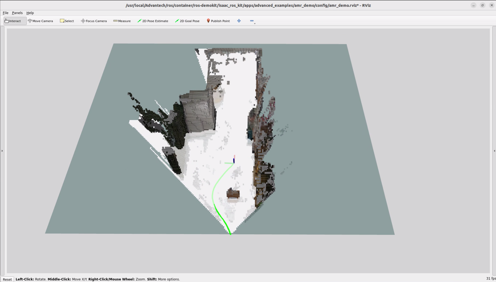

When the blueprint is executed:
  1. RViz will launch with the predefined configuration and display the results
  2. Nav2 will generate paths based on the costmap provided by ISAAC Nvblox

  • /camera_0/color/image : Color image stream from the 3D camera
  • /nvblox_node/color_layer : Visualization of the color layer in Nvblox
  • /nvblox_node/combined_occupancy_grid : Combined occupancy grid used by Nvblox for mapping and costmaps
  • /visual_slam/tracking/vo_path : Estimated robot trajectory from visual odometry
