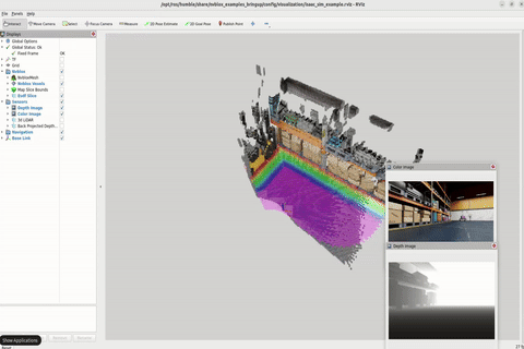

5.1 isaac_ros_nvblox
- Purpose: 3D reconstruction / real-time mapping (TSDF/ESDF). Can be used with a depth camera or dataset to reconstruct and visualize 3D scenes.
- Run:
./launch_isaac.sh basic_examples/isaac_ros_nvblox - Official docs:

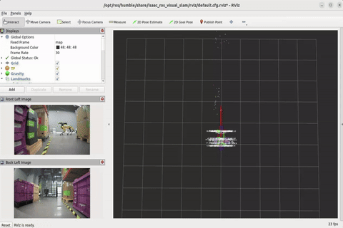

5.2 isaac_ros_visual_slam
- Purpose: Visual SLAM (localization and mapping), including common camera/IMU workflows.
- Run:
./launch_isaac.sh basic_examples/isaac_ros_visual_slam - Official docs:

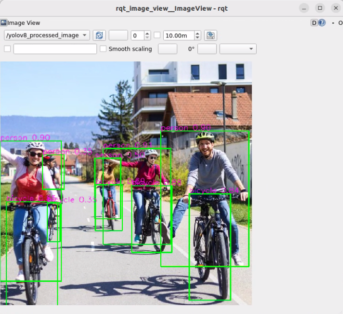

5.3 isaac_ros_yolov8
- Purpose: YOLOv8 object detection inference for real-time detection and perception integration.
- Run:
./launch_isaac.sh basic_examples/isaac_ros_yolov8 - Official docs:

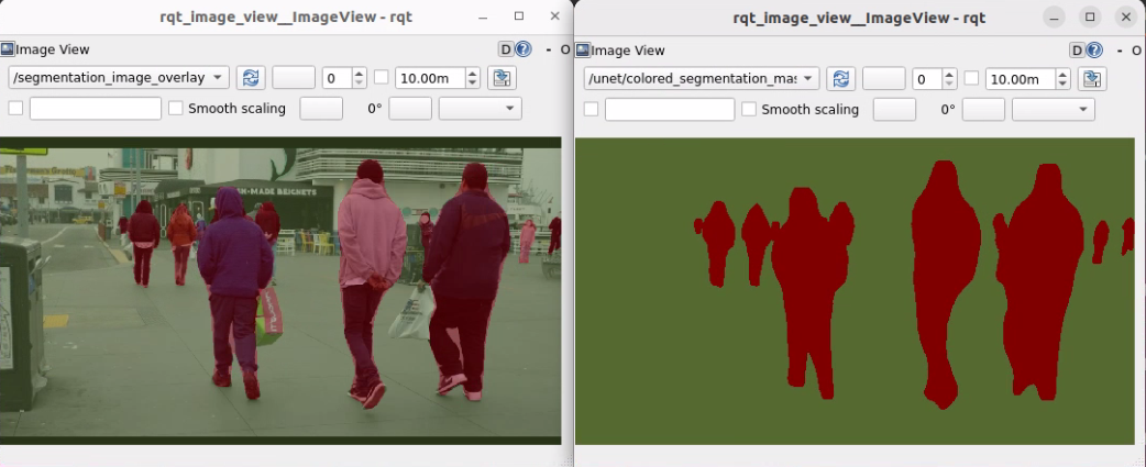

5.4 isaac_ros_unet
- Purpose: UNet-based semantic segmentation workflow, useful for scene understanding, traversability, and foreground/background separation.
- Run:
./launch_isaac.sh basic_examples/isaac_ros_unet - Official docs:

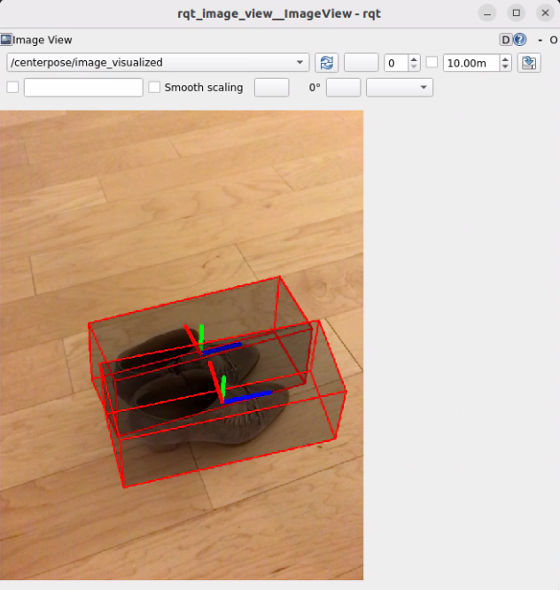

5.5 isaac_ros_centerpose
- Purpose: 6DoF pose estimation, commonly used for grasping, pose tracking, and alignment tasks.
- Run:
./launch_isaac.sh basic_examples/isaac_ros_centerpose - Official docs:

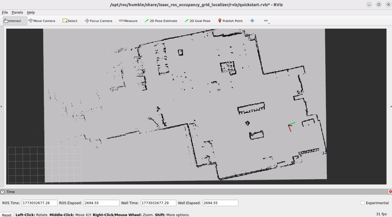

5.6 isaac_ros_occupancy_grid_localizer
- Purpose: Localization on a 2D occupancy grid map (common in indoor navigation / AMR scenarios) to estimate the robot pose on a known map.
- Run:
./launch_isaac.sh basic_examples/isaac_ros_occupancy_grid_localizer - Official docs:
