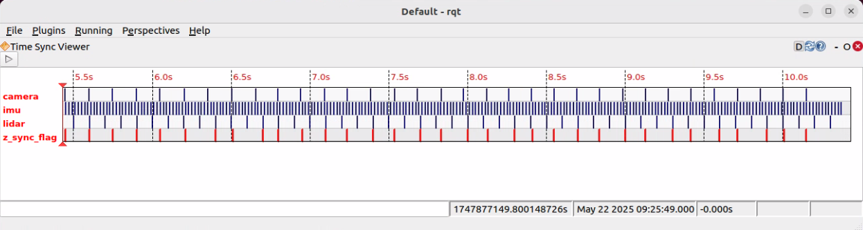

  1. Time Axis Display
    The image displays the timestamps of different data streams (topics), where each horizontal line represents a topic. Examples include:
    • camera (camera image)
    • imu (IMU data)
    • lidar (LiDAR scan)
    • z_sync_flag (sync flag)

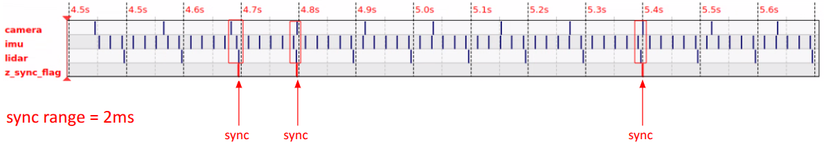

  2. Synchronization Range
    • In this example, the sync_range is set to 2 milliseconds. All data points that arrive within this 2-millisecond window are considered synchronized.
    • On the time axis, when a synchronization event is triggered, a sync_flag is marked. At the moment of triggering, the timestamp of the flag aligns with that of the last received data point. This set of data will not be used for the next synchronization detection.
  3. Synchronization Analysis
    • When all sensor data points fall within the 2-ms range, they are considered synchronized (sync).
    • The image displays multiple sync points, indicating that at those moments, the sensor data is properly synchronized.

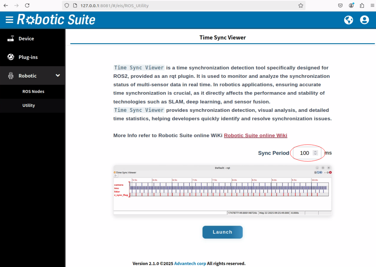

Step 2: Enter 127.0.0.1:8081 in a web browser. The account is root, the password is P@ssw0rd. Run Time Sync Viewer in Web UI, select Utility from the list on the left.
Robotic-suite-quickstart-tutorials2_01
Step 3: Set Sync Period to a value between 1ms and 2000ms (default: 100ms).
Robotic-suite-quickstart-tutorials2_07

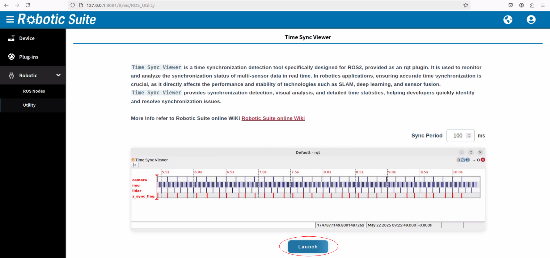

Step 4: Click launch button, then the Time Sync Viewer window will open.
Robotic-suite-quickstart-tutorials2_02

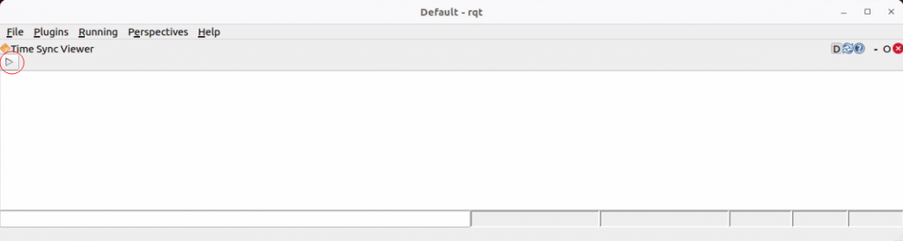

Step 5: Click start button.
Robotic-suite-quickstart-tutorials2_03

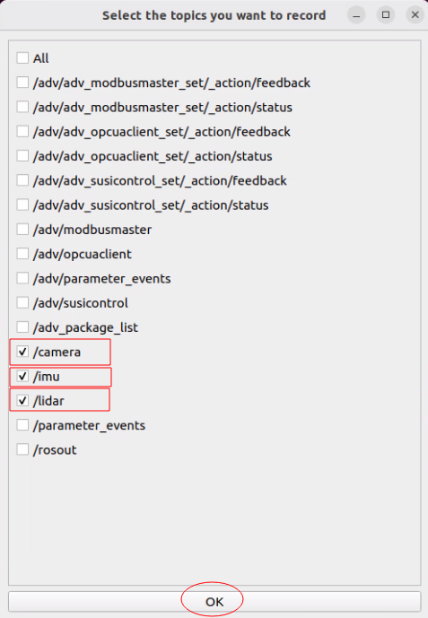

Step 6: Select the topics that you want to view, then click OK.
Robotic-suite-quickstart-tutorials2_04
