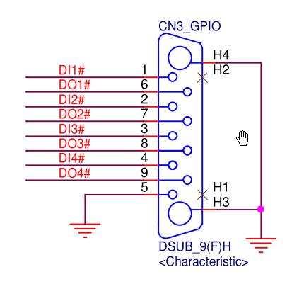

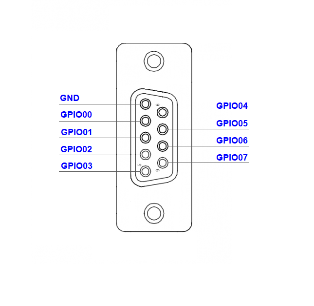

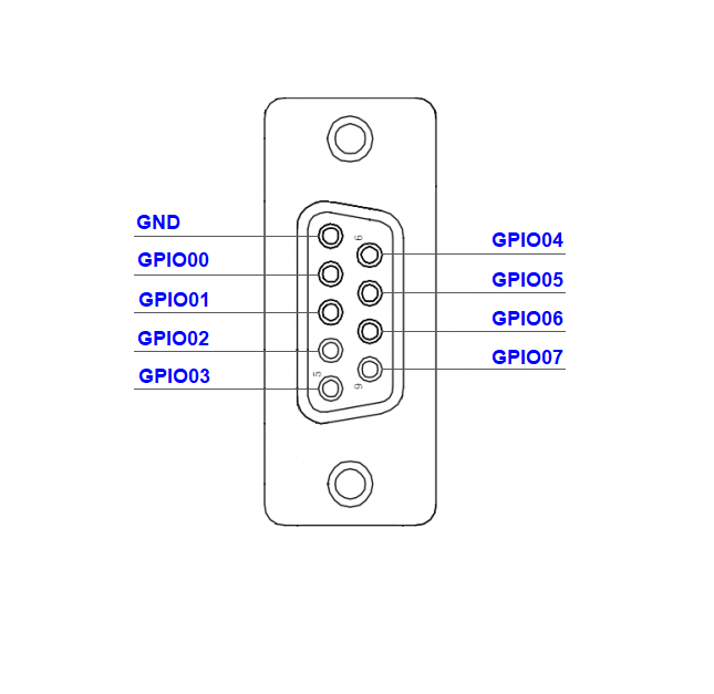

Use Case: EPC-R3720 GPIO Usage
This case is a demonstration to instruct EPC-R3720 GPIO configuration and usage.
- GPIO Pins definition:
- GPIO Mapping Table:
**NOTE:**GPIO2 and GPIO4 are not connected to D-sub connector
- Hardware Config:
In this demonstraction, we would like to do a loopback test from DO to DI, before start below steps, we need to wire-connect from DO to DI for each:
DO1 (GPIO6)    ---   DI1 (GPIO5)
DO2 (GPIO8)    ---   DI2 (GPIO7)
DO3 (GPIO10)  ---   DI3 (GPIO9)
DO4 (GPIO12)  ---   DI4 (GPIO11)

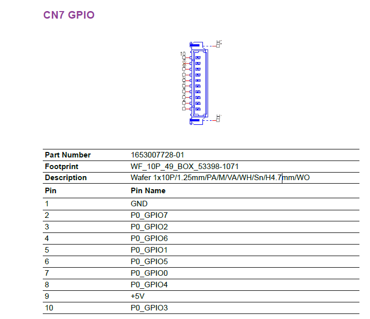

Use Case: MIO-5375 GPIO Usage
This case is a demonstration to instruct MIO-5375 GPIO configuration and usage.
- GPIO cable definition:
**NOTE:**All GPIO direction are configable.
- Hardware Config:
DO1 (GPIO00)    ---    DI1 (GPIO04)
DO2 (GPIO01)    ---    DI2 (GPIO05)
DO3 (GPIO02)    ---    DI3 (GPIO06)
DO4 (GPIO03)    ---    DI4 (GPIO07)
