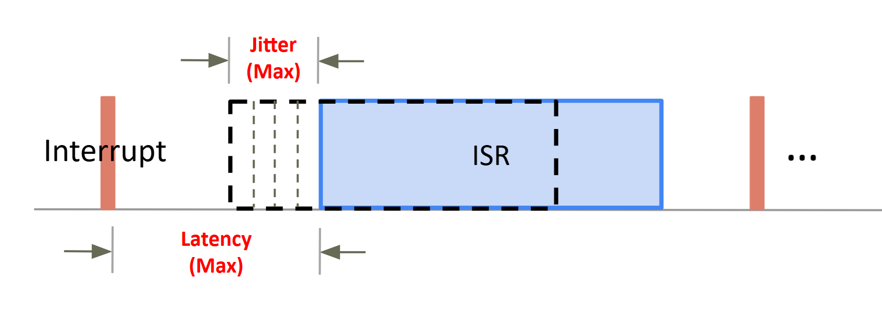

Metrics of Real-Time Performance
The value of Real-Time OS is realized through its improvements to two critical real-time metrics: Latency and Jitter. Improvement goal of realtime OS is reducing Worst-Case Latency (Max Latency) and narrowing the Response Time Variation (Max Jitter).
realtime-os-latency-jitter
  • Latency is the time elapsed from when an event occurs (e.g., a high-priority task becomes ready) to when the system actually starts responding to that event (e.g., the CPU begins executing the task).
    In the standard kernel, low-priority tasks can hold kernel locks for long durations, forcing high-priority tasks to wait, and some critical interrupt processing can be delayed for too long. the Worst-Case Latency is often high and unpredictable.
  • Jitter refers to the variation or fluctuation range in the response time or execution time of successive tasks. In a real-time system, not only must the average response time be fast, but the variation in response time must also be small.
    In the standard kernel, Jitter is high; a task might respond very quickly at one moment and very slowly at another (e.g., when the kernel is executing a resource-intensive operation).
