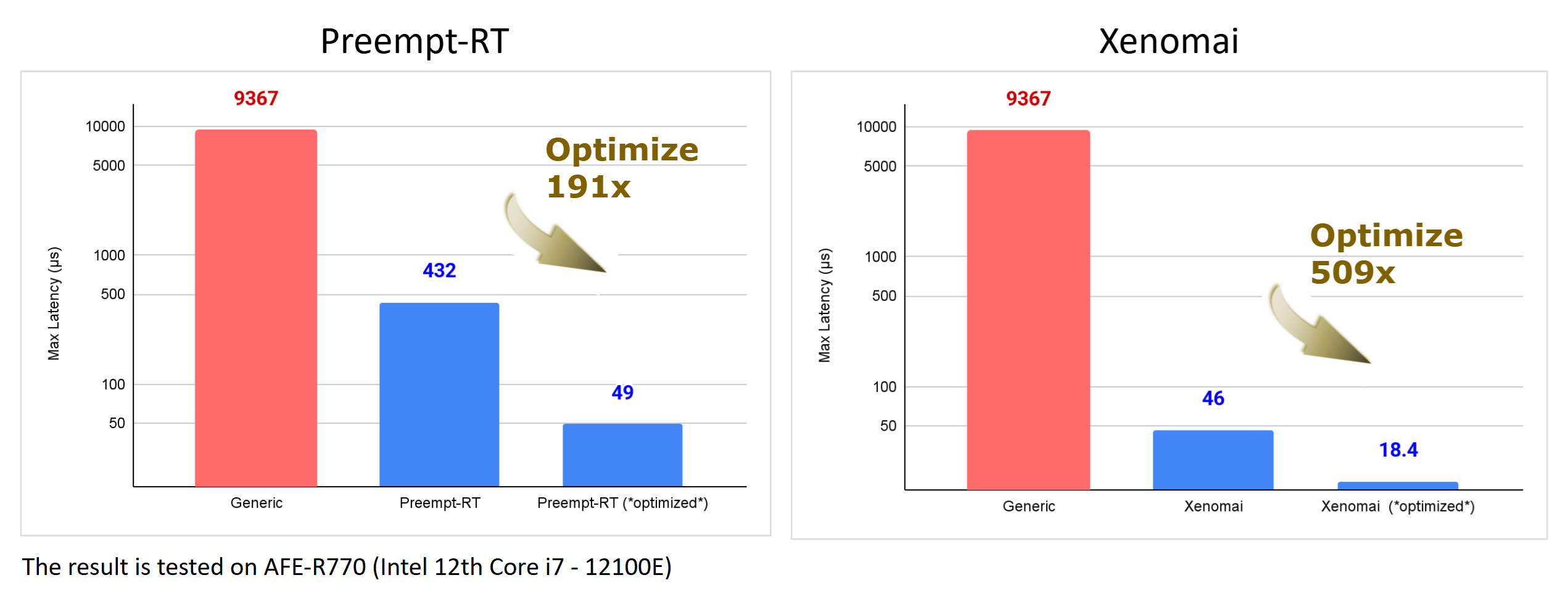

Performance Improvement
Advantech's Embedded Software team provides highly optimized real-time system configurations, along with fully validated and rigorously tested Preempt-RT and Xenomai solutions. When deployed on Advantech devices, these solutions significantly enhance the system's real-time computing capabilities and ensure optimal real-time performance.

Performance ReportDetailed real-time benchmark results (latency, jitter, IRQ response), before and after optimizationQuantifiable proof of real-time performance
