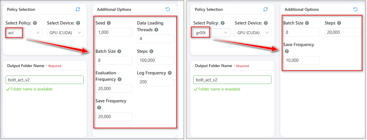

1. The policy determines the fields displayed​
The parameter fields under ACT and GR00T N1.5
The parameter area of the training page adapts its content to the policy selected (act on the left of the figure above, gr00t on the right; the areas outlined in red are those that change):
  • ACT selected: all seven fields are displayed.
  • GR00T N1.5 selected: only three fields are displayed — batch size, steps, and save frequency.
The basis for the difference​
The four fields not displayed (seed, num workers, eval frequency, and log frequency) are not received by GR00T's training process, and entering values would not affect the training result. The interface conceals them rather than retaining them as editable fields, and consequently the fields displayed are the fields that take effect.
Where training performance does not meet expectations, the cause does not lie in the parameters on this page; refer to the discussion of GPU utilization in Training Monitoring.
Differences in default values​
On switching policies, the values displayed are automatically replaced with the initial values for that policy:
ItemACTGR00T N1.5
Nature of learningTraining from scratchFine-tuning on a pretrained base
Batch size88
Steps100,00020,000
Save frequency20,00010,000
Seed / num workers / eval frequency / log frequencyDisplayedNot displayed
This difference derives from the nature of learning in each policy: ACT must learn the complete motion from scratch and requires a higher number of iterations, whereas GR00T N1.5 fine-tunes a pretrained model that already possesses general robotic motion capability and requires substantially fewer steps, with the save frequency shortened accordingly. The default batch size is the same for both policies; the GR00T model is, however, larger in scale and consumes more GPU memory at a given batch size, so its practical upper limit is lower.
caution
Order of configuration Switching policies overwrites values that have already been modified. This is expected behaviour, as the parameter set for the previous policy is not applicable to the new one. The policy should therefore be determined first and the parameters adjusted subsequently.

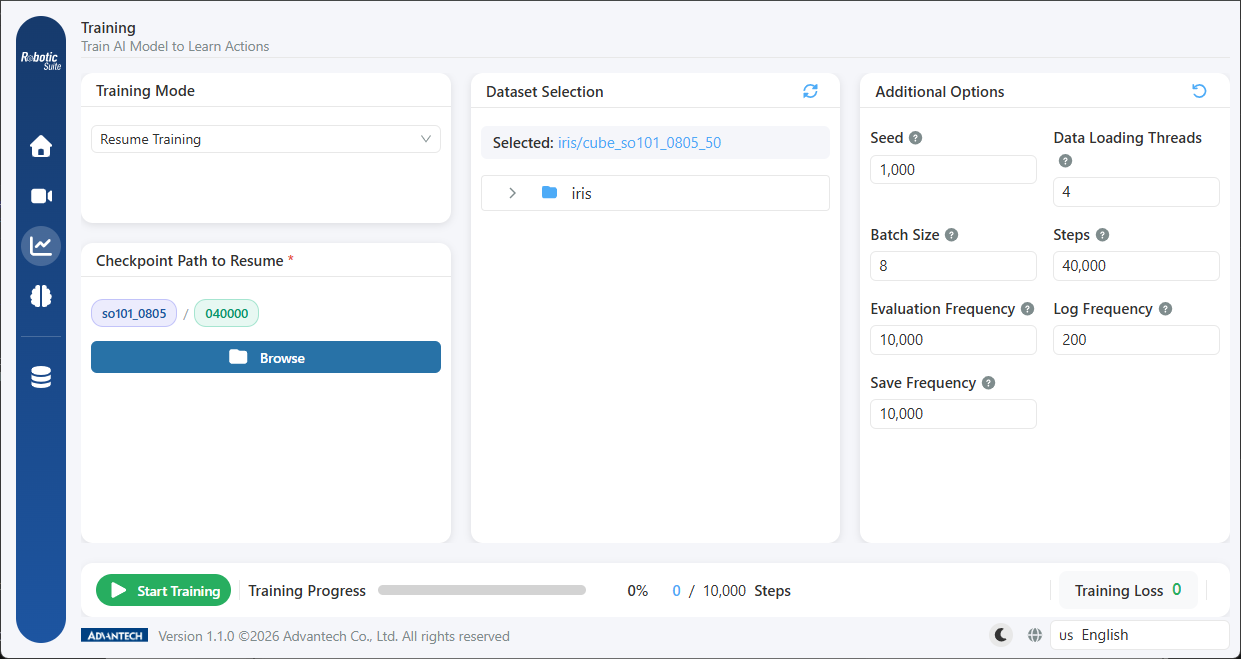

5. New training and resume training​
The "Training Mode" control offers two options:
New training. Training begins from the initial state. This is the default.
Resume training. Training continues from an existing progress save. Once selected, the progress save is specified via "Browse", and the platform loads it automatically upon selection.
Resume training
Following the load, the screen marks the selected save as "model name / step count" and restores the original parameters of that run. Resume training constitutes the continuation of the same run, and the parameters should therefore remain as originally configured.
For the applicable circumstances, see Training Monitoring & Resume.
