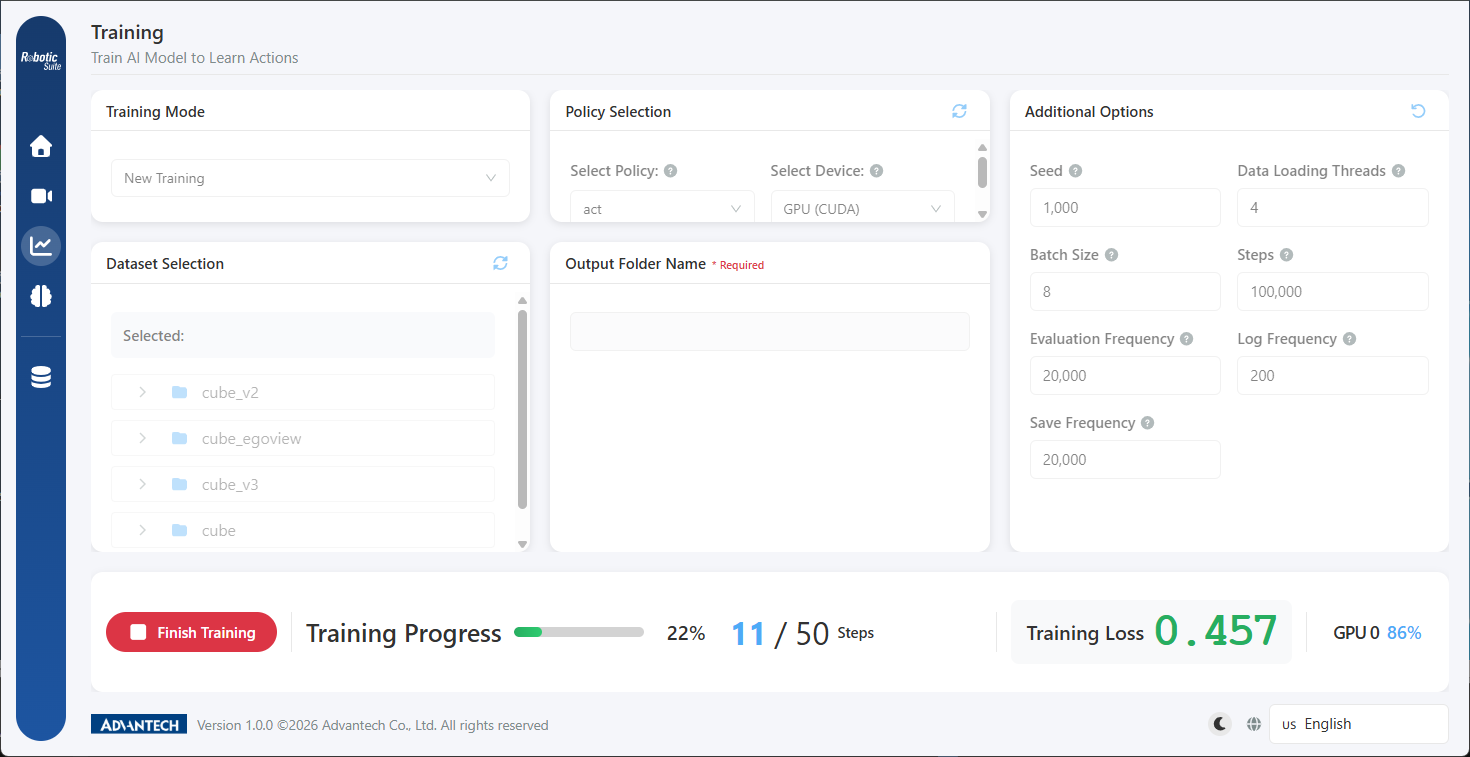

Once training has started, a persistent status bar is displayed at the bottom of the page comprising four categories of information:
| Item | Content |
| Training progress | Progress bar and percentage, calculated as current step ÷ configured total steps |
| Current step | Training steps completed |
| Training loss | The current loss value, the principal basis for assessing the state of learning |
| GPU status | Utilization of each GPU; hovering displays memory used, available, and total |
Progress reflects the remaining execution time, loss reflects the state of learning, and GPU utilization reflects the efficiency with which compute resources are being used. A "Finish Training" button occupies the far left of the status bar; its use is described in the fourth section of this chapter.

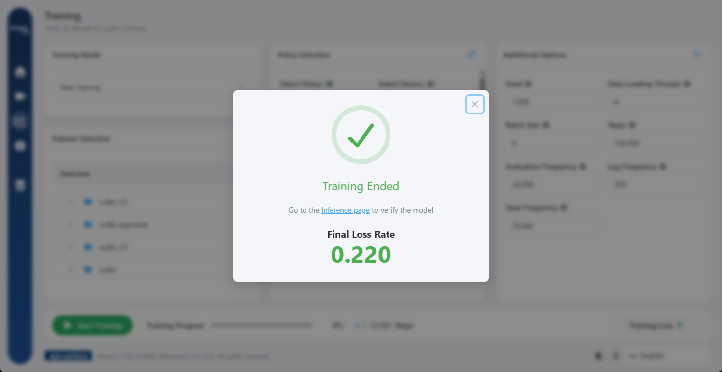

On completion of training, the platform displays a "Training Ended" summary containing the final loss rate and a link to the inference page.
This value should be recorded before the dialog is closed, together with the policy, dataset, and total steps used for the run — none of which appear in the summary. When subsequent model versions are trained, this record constitutes the sole basis for version comparison, and such comparison carries meaning only between runs of the same policy on the same dataset.
All values at the training stage are indirect indicators; the practical viability of the model must be confirmed through inference verification.
