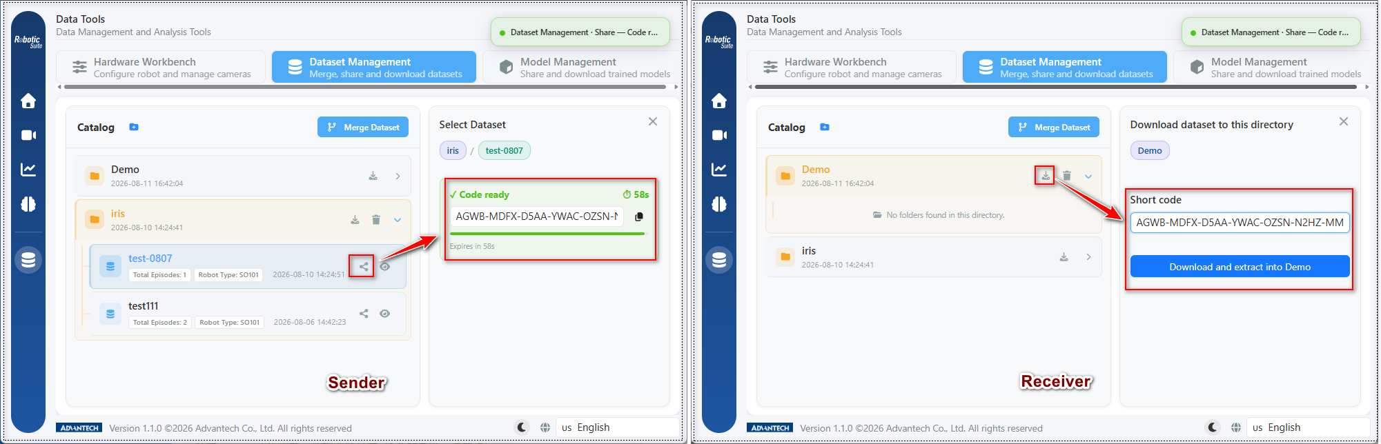

The sending and receiving hosts in a short-code transfer
The transfer procedure is identical for datasets and models, and comprises three steps:
  1. Sending host (left above): expand the folder in the catalog, select the item to be transferred, and select the share icon on that row. The platform compresses the item and displays "Code ready" on the right, containing a short code (in the form AGWB-MDFX-D5AA-YWAC-...) together with an expiry countdown; the code is obtained via the copy button.
  2. Receiving host (right above): first select the destination folder in the catalog, then select the download icon on that row, whereupon a short code field appears on the right. Paste the code and select the button below it, which is labelled with the actual destination folder name (for example, "Download and extract into Demo").
  3. Completion: the platform downloads and extracts the item into that folder automatically.
The destination is determined by the operator's selection in step 2 rather than by the code; the selected folder should therefore be confirmed before receiving.
