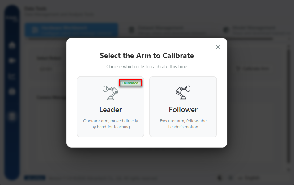

Select the arm to calibrate
The calibration function is located at Data Tools → Hardware Settings → Arm Calibration. On entry, the role to be calibrated (Leader or Follower) must be selected; roles already calibrated are marked with a "Calibrated" badge (outlined in red above; in this example the Leader is complete and the Follower has not yet been performed).
This state is restored from the backend calibration record rather than from browser-side storage, and is therefore displayed correctly when the interface is opened on a different computer.

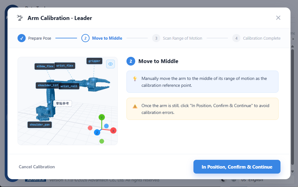

Step 2: Move to the middle position​
Move the arm manually to the middle of its range of motion to serve as the calibration reference point, then click "In Position, Confirm & Continue".
The 3D model on the left of the screen labels the six joint names together with the zero reference, and may be used to identify the position of each joint on the physical arm.
The system samples at the instant the button is pressed. If the arm is still supported by hand, or is descending under gravity, the value obtained will be a drifting one. Sampling should be performed only after the arm has come fully to rest.

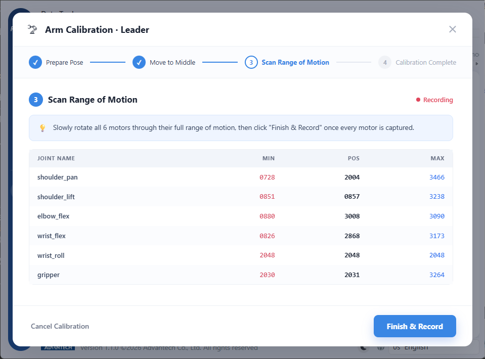

This step constitutes the core of calibration. Following the on-screen prompt, rotate all six motors slowly to both ends of their range of motion, while the system displays the minimum (MIN), current (POS), and maximum (MAX) values for each motor in a live table, with a "Recording" indicator in the upper right. Once all six motors have been scanned, click "Finish & Record".
That table is the sole acceptance criterion for this step. If a joint's minimum and maximum values are approximately equal, the motor in question was not actually rotated and the scan must be repeated for it. The figure above illustrates this: all three values in the wrist_roll row read 2048, indicating that the joint has not been rotated since this step was entered. Clicking "Finish & Record" in this state would record a range of motion of zero for that joint.

Common operational errors and their consequences:
OperationConsequence
Excessive rotation speedSampling has an upper frequency limit; endpoints may be skipped and a smaller-than-actual range recorded
Rotation only to the midpointThe recorded range is too small, and the arm cannot reach certain poses during demonstration
Gripper not scannedGrasping cannot be learned. gripper is also a motor, and is the most commonly omitted item
Collision with an obstacle during the scanA false endpoint constrained by external force is recorded, with possible damage to the servo
"Slowly" and "to both ends" are specific requirements: rotation should continue until resistance is felt and the mechanism reaches the end of its travel.
