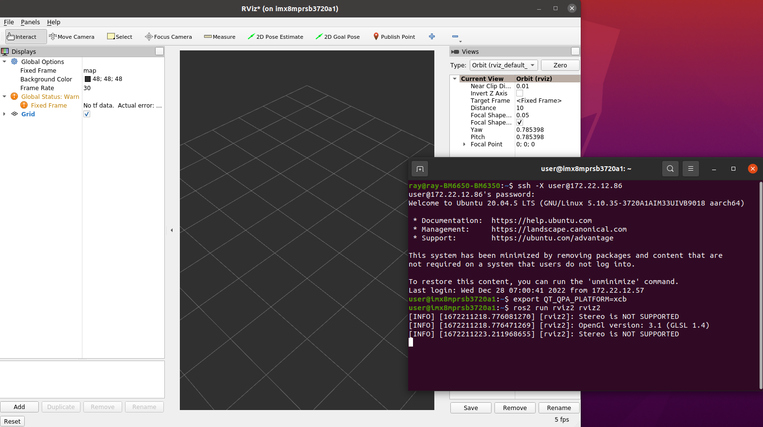

Prepare a x86_64 Ubuntu 20.04. Use ssh -X to enable graphical applications on a remote server. Notice : it is -X not -x
$ ssh -X remote-user@remote-host
$ export QT_QPA_PLATFORM=xcb
Run RViz2
$ ros2 run rviz2 rviz2
RViz_X11
