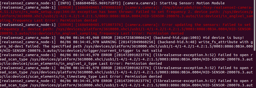

Known issues of realsense camera​
  1. IMU issues If you can't use the D435i's IMU on ROS2, and see "Permission denied" error message.
ROS2_Suite_D435i-imu-issue
You can install a patch to resolve this issue. Reference solution: librealsense patch
