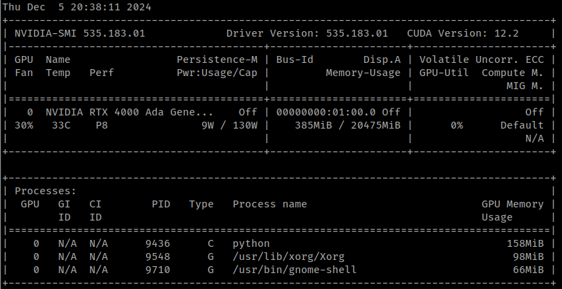

Step 1: Hardware Verification
Prerequisites:
- NVIDIA GPU device
- Ubuntu OS (22.04 recommended)
- Latest NVIDIA driver installed
Verification Commands:
# Check GPU presence
nvidia-smi
# Check CUDA version
nvcc --version

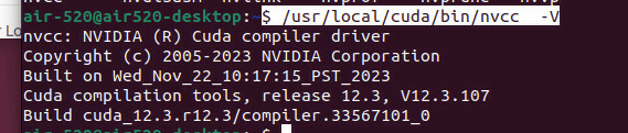

Step 3: Install CUDA Toolkit
If you are use Jetson platform, you can skip this step.
Installation:
# Add CUDA repository
wget https://developer.download.nvidia.com/compute/cuda/repos/ubuntu2204/x86_64/cuda-keyring_1.1-1_all.deb
sudo dpkg -i cuda-keyring_1.1_all.deb
sudo apt update
# Install CUDA Toolkit 12.6
sudo apt install cuda-toolkit-12-6
Verification:
# Check CUDA installation
/usr/local/cuda/bin/nvcc -V

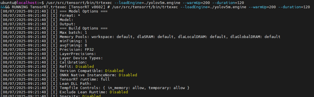

Step 6: Run TensorRT Engine
Execution:
# Load and run the TensorRT engine
# Jetson please use /usr/src/tensorrt/bin/trtexec
$ trtexec --loadEngine=model_int8.engine \
--warmUp=200 \
--duration=120 \
--device=0

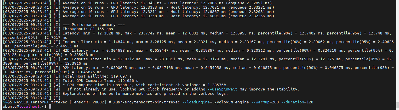

Performance Metrics:
- WarmUp: 200 iterations to stabilize
- Duration: 120 seconds measurement period
- Device: GPU device index (0 for single GPU)
