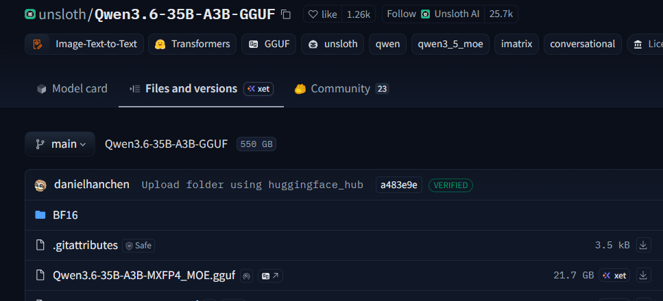

Step 3: Download GGUF Model
Download model from huggingface, we use unsloth/Qwen3.6-35B-A3B-GGUF as example.
download_hugginigface

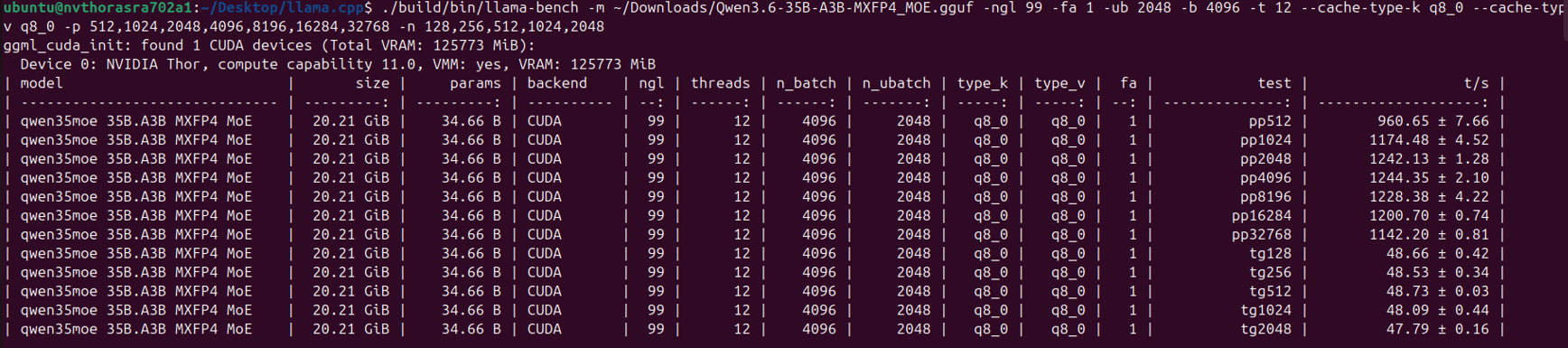

Step 4: Run Baseline Test (Customer Parameters)
Baseline Test:
./build/bin/llama-bench \
-m ./Qwen3.6-35B-A3B-MXFP4_MOE.gguf \
-ngl 99 \ # offload all layers to GPU
-fa 1 \ # enable flash attention
-ub 2048 -b 4096 \
-t 12 \ # 12 threads (14 cores available)
--cache-type-k q8_0 --cache-type-v q8_0 \
-p 512,1024,2048,4096,8192,16284,32768 \
-n 128,256,512,1024,2048
Results:
  • Initial throughput: ~48 t/s
  • System runs stably but performance is limited
Baseline Test

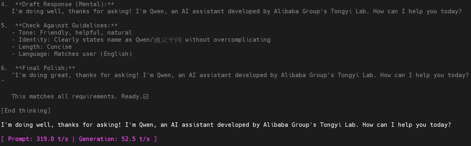

Step 7: Run Model Inference (llama-cli)
Optimized Execution:
./build/bin/llama-cli -m ~/Downloads/Qwen3.6-35B-A3B-MXFP4_MOE.gguf \
-ngl 99 \
-fa 1 \
-ub 2048 \
-b 4096 \
-t 12 \
-n 512 \
-p "what's up"
Results:
  • Baseline: ~48 t/s (with thermal throttling)
  • After performance mode: ~52 t/s (8% gain)
Performance Comparison

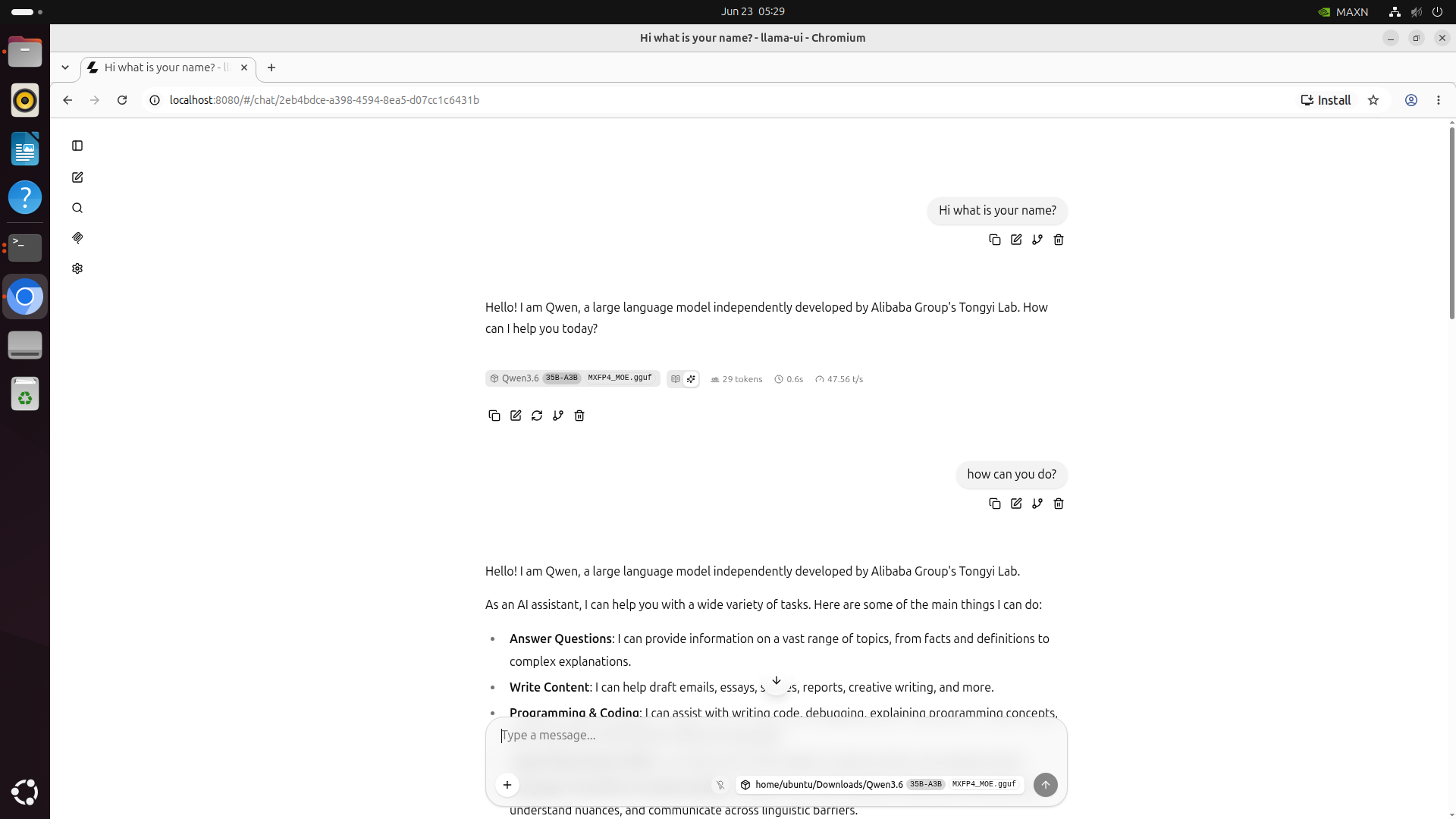

Step 8: Launch Web UI (llama-server)
Server Setup:
./build/bin/llama-server \
-ngl 99 \
-fa 1 \
-ub 2048 \
-b 4096 \
-t 12 \
--cache-type-k q8_0 \
--ctx-size 8192 \
--host 0.0.0.0 \
--port 8080
Access from browser
http://localhost:8080
Web UI
