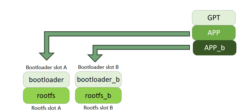

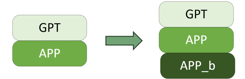

It uses two root file systems:
  • Rootfs A: Stored in the usual file system partition (APP)
  • Rootfs B: Stored in a new partition (APP_b), located after APP on the disk
Rootfs A/B Partition Layout

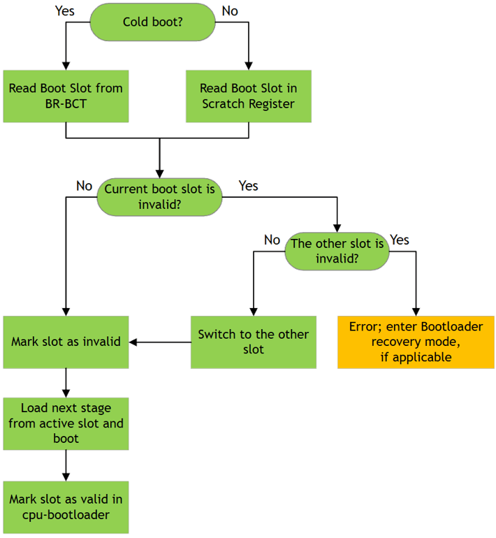

Each rootfs is independent and occupies a slot: "slot A" or "slot B".
  • Bootloader A always boots with rootfs A
  • Bootloader B always boots with rootfs B
Bootloader and Rootfs
  • Boot ROM retrieves the target slot number from either the BR-BCT or Scratch Registers.
  • Load the corresponding Bootloader stages and boot to the assigned rootfs partition.

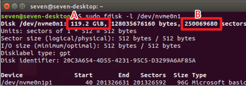

Step 4: Get Storage Parameters​
sudo fdisk -l /dev/nvme0n1
Example:
  • Storage_real_size: 119.2 GB
  • Sectors_number: 250069680

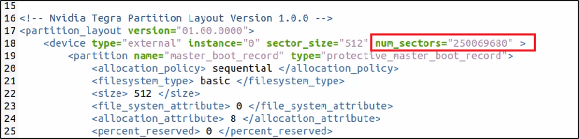

Step 5: Modify Config File​
sudo gedit Linux_for_Tegra/tools/kernel_flash/flash_l4t_t234_nvme_rootfs_ab.xml
Set num_sectors to Sectors_number.

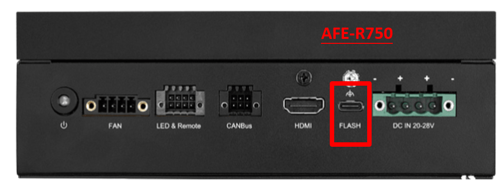

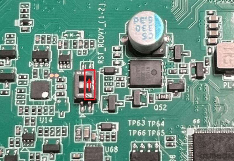

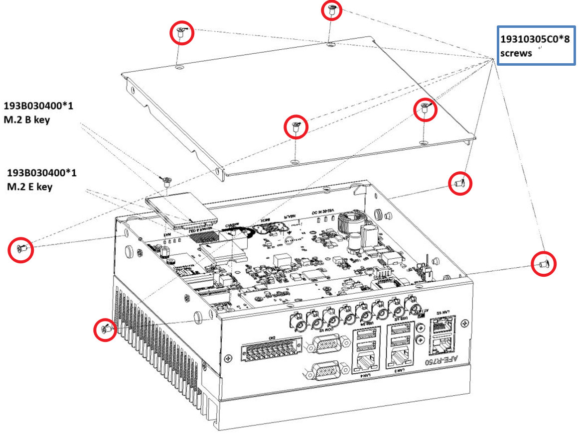

Step 6: Put Device in Recovery Mode​
  1. Shutdown Jetson device
  2. Connect USB to FLASH port Power Off and Connect
  3. Open bottom cover Recovery Setup
  4. Set RST_RCOVY pin 2 to ON
  5. Press power button Recovery Pins
