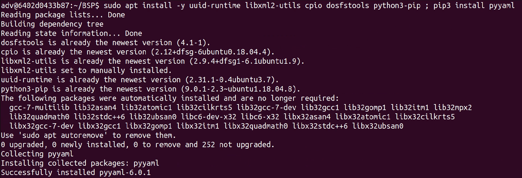

Step 3: Install Dependencies in Container
In order to build OTA package, container has to install some dependences by apt command.
sudo apt update
sudo apt install -y uuid-runtime libxml2-utils cpio dosfstools python3-pip
pip3 install pyyaml

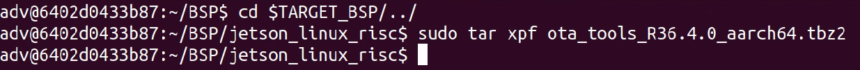

Step 5: Setup OTA Tool
Put the OTA tool into $TARGET_BSP/../ which should be /home/adv/BSP/jetson_linux_risc/ and extract the OTA tool.
cd $TARGET_BSP/../
sudo tar xpf ota_tools_R36.4.0_aarch64.tbz2

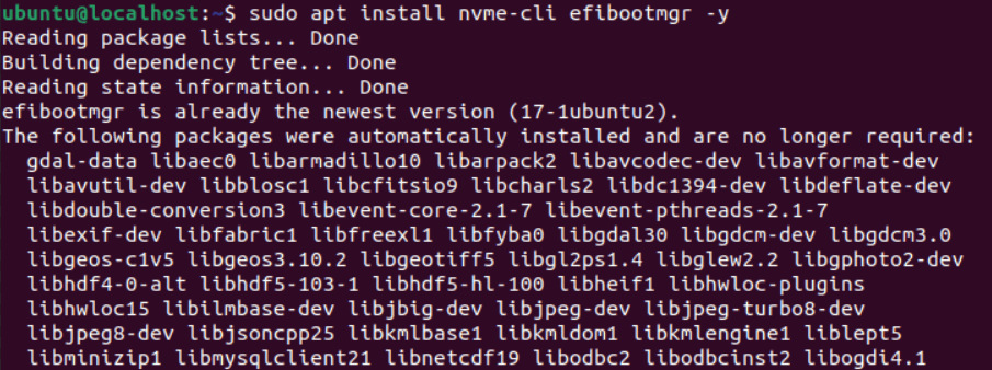

In order to do OTA update, AFE-R750 has to install two dependences by apt command.
sudo apt update
sudo apt install -y efibootmgr nvme-cli

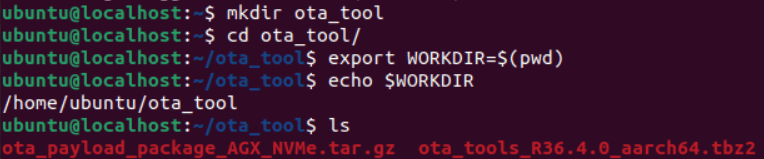

Setup WORKDIR
Create a ota_tool folder and put OTA tool and OTA image inside. Set the ota_tool absolute path as WORKDIR.
mkdir -p /home/ubuntu/ota_tool
export WORKDIR=/home/ubuntu/ota_tool
Setup OTA Tool
Extract the OTA tool in ota_tool folder. Create /ota folder and move OTA image into /ota.
cd /home/ubuntu/ota_tool
sudo mkdir /ota
sudo mv `<your_ota_package.tar.gz>` /ota

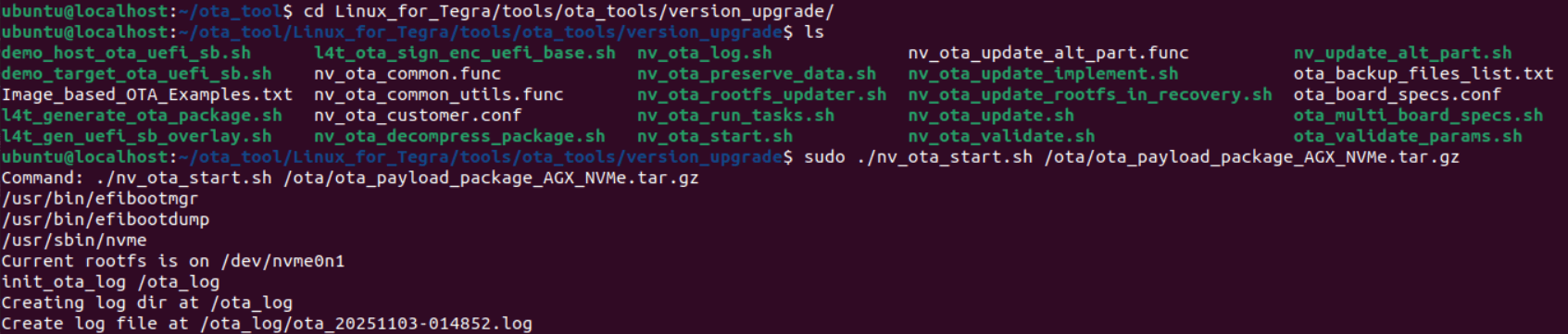

Step 8: Trigger OTA Update
From WORKDIR go to OTA trigger script folder and Trigger the OTA update.
cd Linux_for_Tegra/tools/ota_tools/version_upgrade
sudo ./nv_ota_start.sh /ota/<your_ota_package.tar.gz>

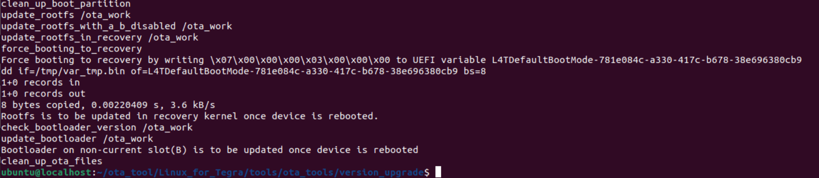

Step 9: Complete Update
After trigger finishes, reboot the system.
sudo reboot
Note: After reboot, device shows black screen for ~30 minutes. DO NOT power off.
