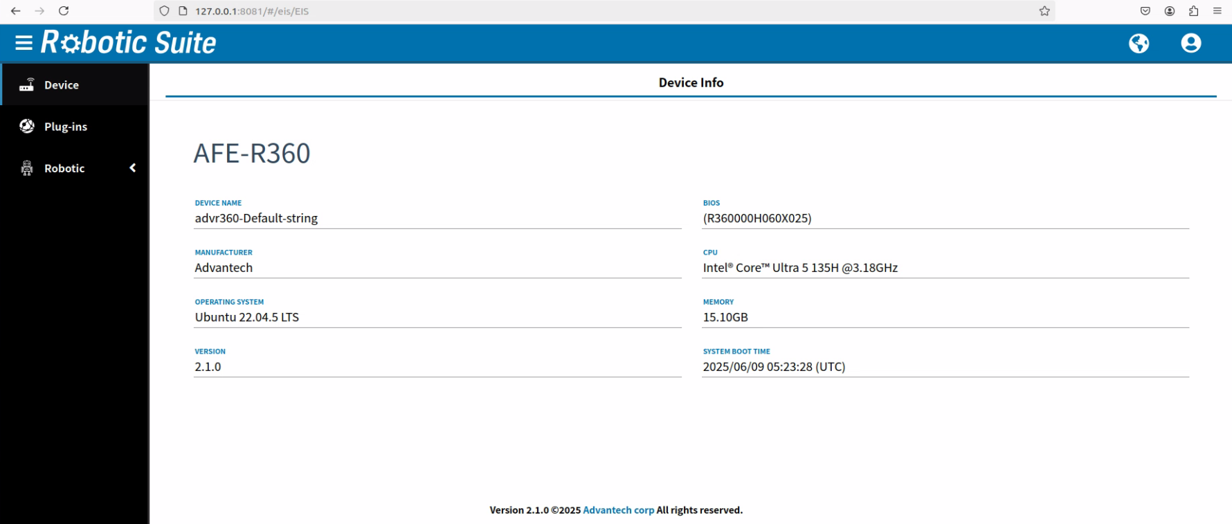

  • Step 1: Open your browser and go to 127.0.0.1:8081

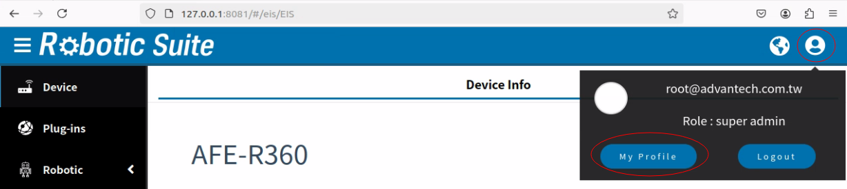

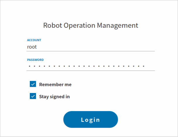

  • Step 2: Enter the default Password P@ssw0rd then login
    AFE-R360

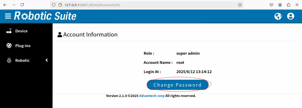

  • Step 3: Recommended to change the password first
  • Step 4: This page will display some system information

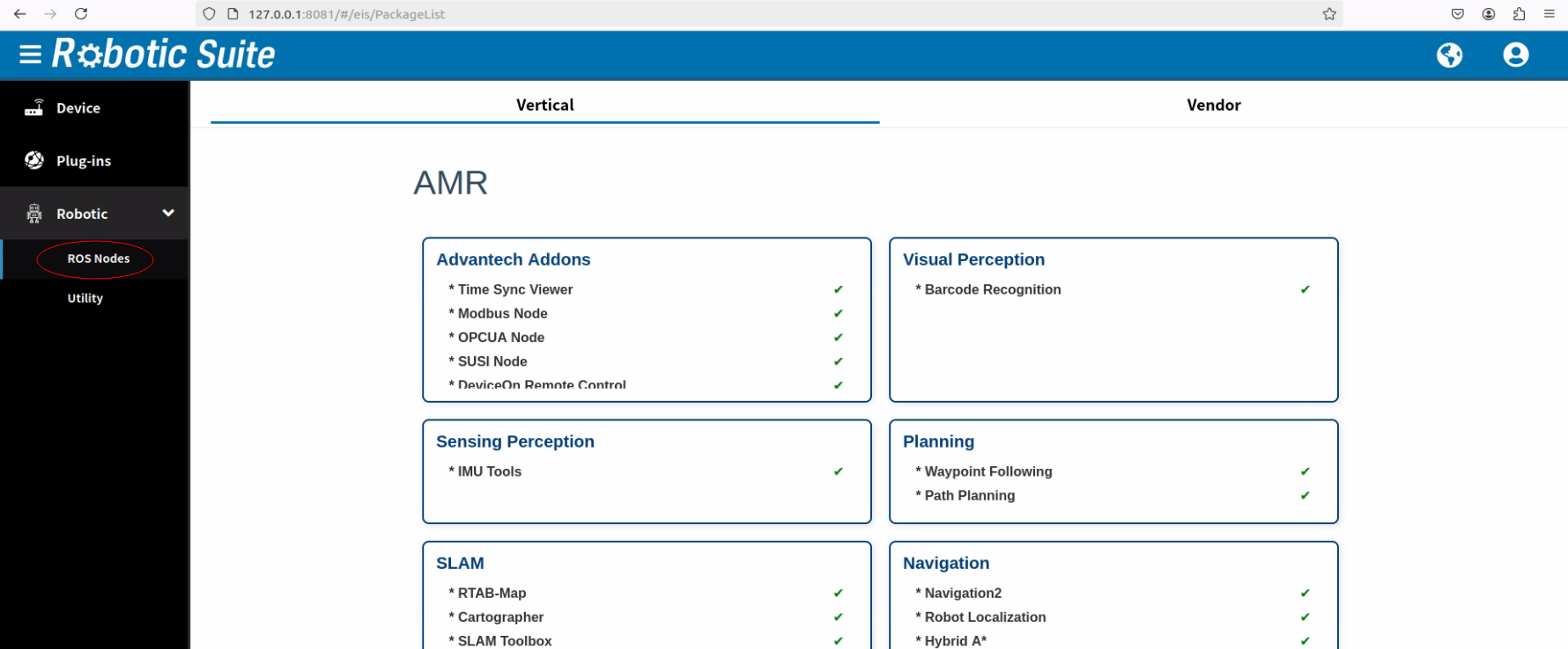

  • Step 5: Next, select "ROS Nodes" from the list on the left
    The vertical page will show open-source ROS2 nodes focused on the AMR field, for more information please refer to AMR SDK

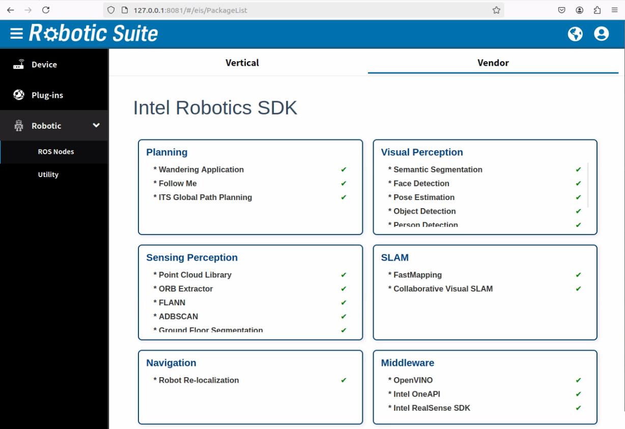

    The vendor page will show a list of nodes from the Intel Robotics SDK, for more information please refer to Intel Robotic SDK 2.2

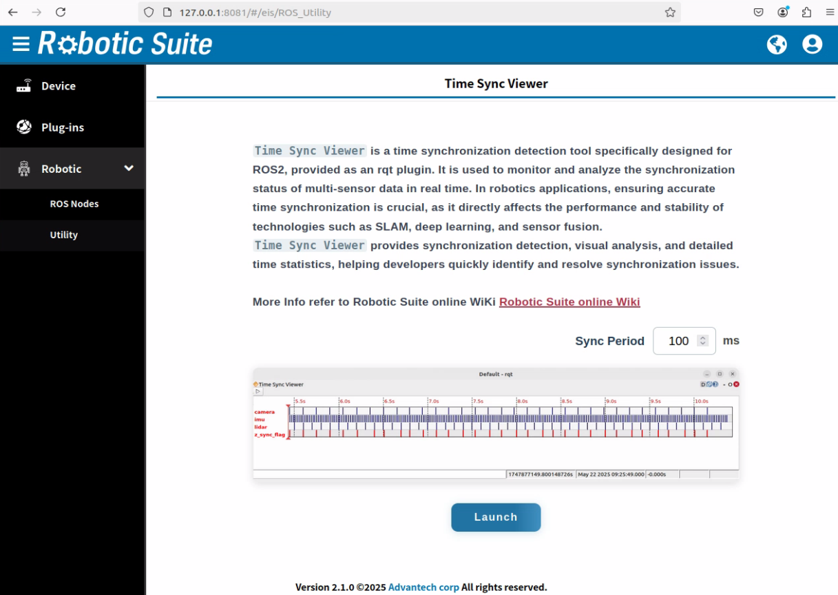

Tutorials 2: Use Muilt Sensors on Time Sync Viewer
In this tutorial, We will publish fake sensor data, including camera, IMU, and LiDAR(you can also use actual sensors). Then display the timestamps in rqt and observe the time synchronization status of the multiple sensors.
For detailed instructions, please refer to Time Sync Viewer

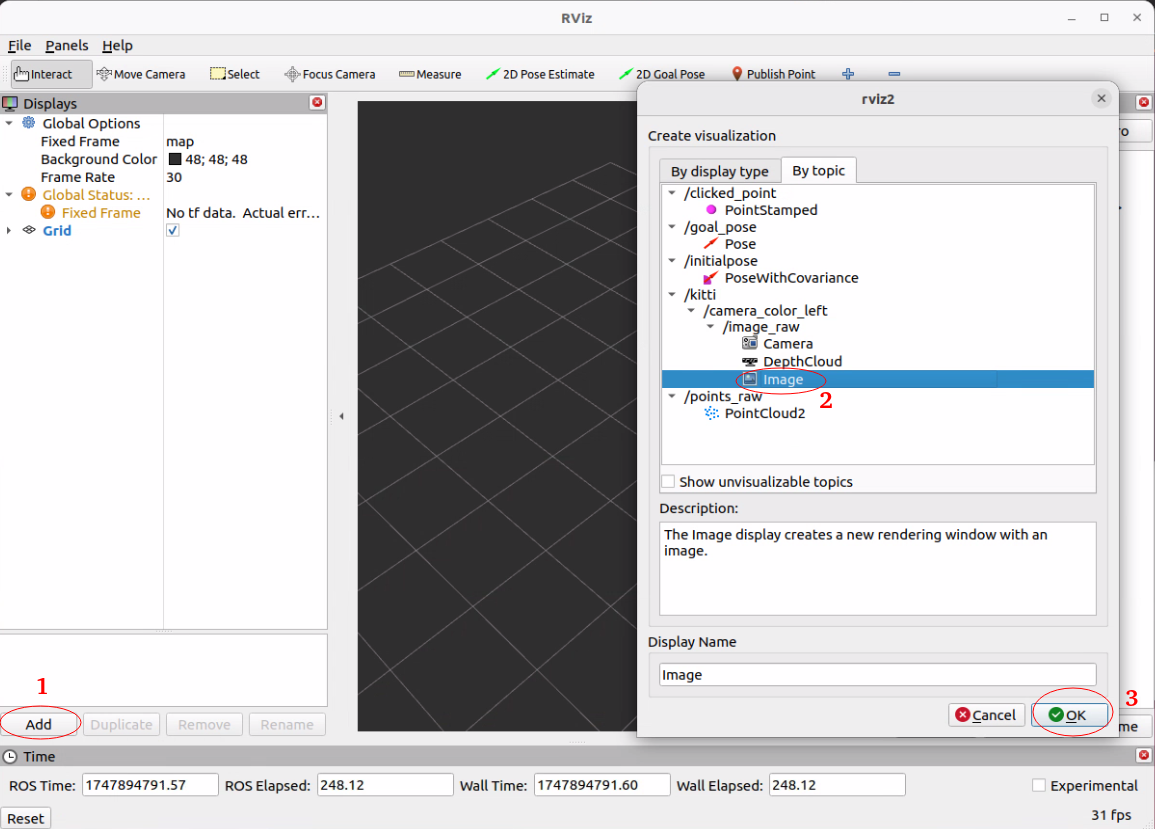

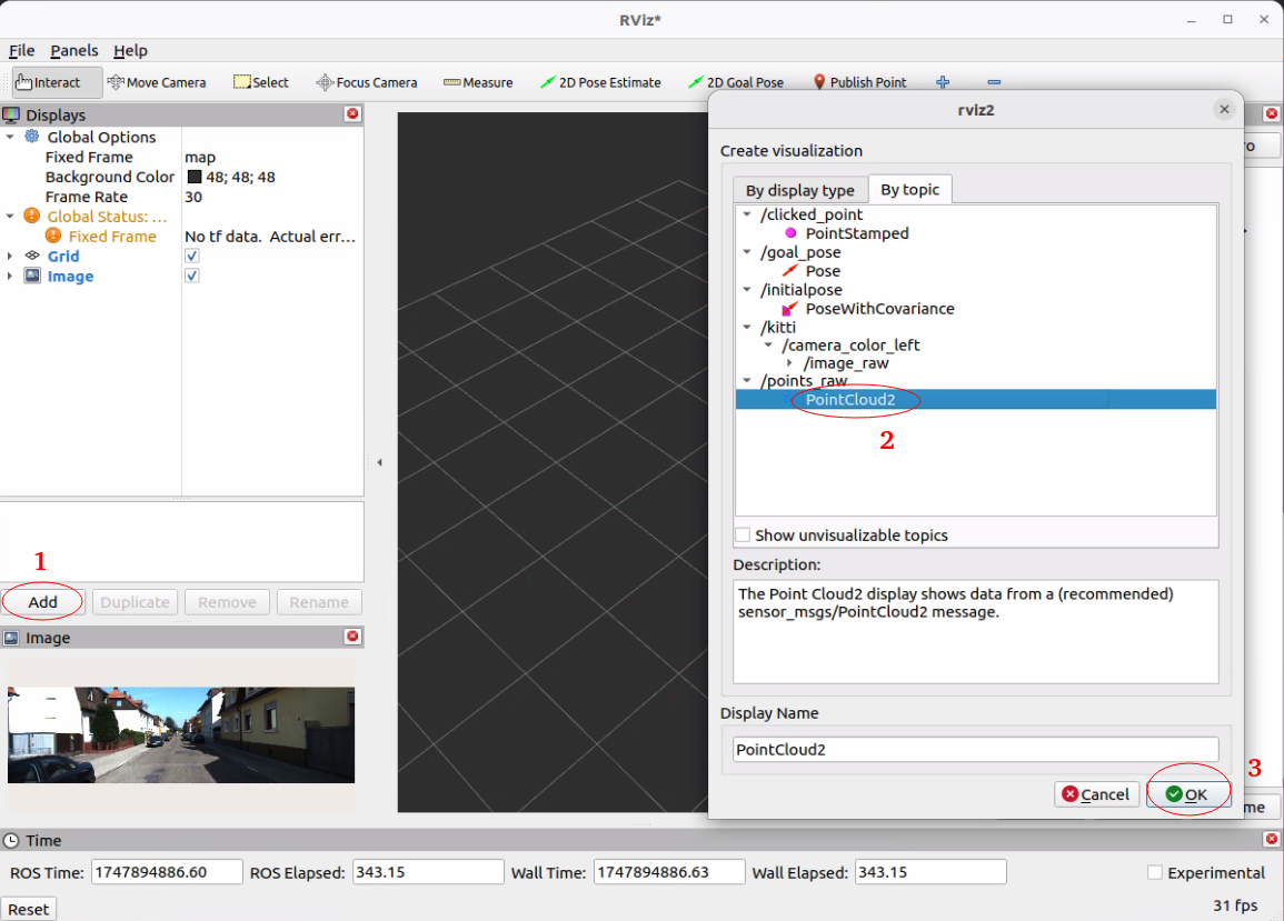

  • Step 4: Add image topic on Rviz
  • Step 5: Add lidar topic on Rviz

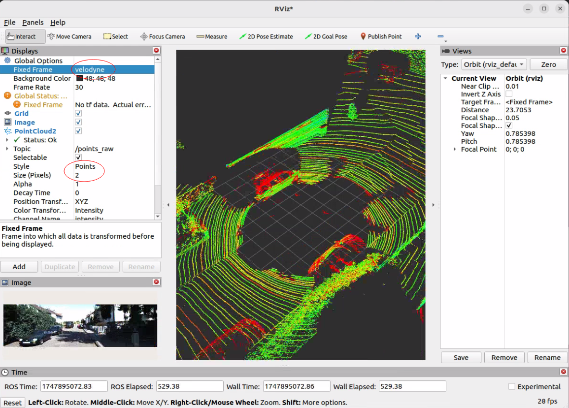

  • Step 6: Set parameters for correct display of pointcloud data
    1.Set Fixed Frame to "velodyne"
    2.Set Style to "Points"
    3.Set Size (Pixels) to "2"
    Result:

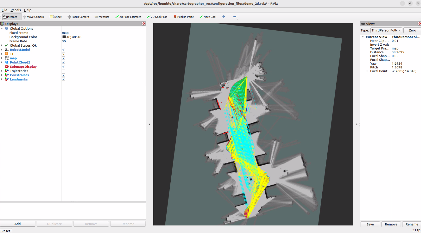

In this tutorial, we will demonstrate how to quickly use Cartographer to build a 2D map. We will first download a sample rosbag that contains Laser LiDAR data, and then show how to configure Cartographer’s parameters and start the mapping process. Finally, we will use RViz to observe the mapping progress and results in real time, allowing users to quickly get started with the 2D SLAM process and create their own maps.
For more information please refer to cartographer_ros
Steps
  • Step 1: Download example bagfile
mkdir ~/slam_example
cd ~/slam_example
wget https://iedgeblob.blob.core.windows.net/iedge-public/rosbag-dataset/rosbag2_2023_08_04-10_54_23.tar.gz
tar zxvf rosbag2_2023_08_04-10_54_23.tar.gz
  • Step 2: Download lua file
cd ~/slam_example
wget -O 2d_slam_example.lua https://iedgeblob.blob.core.windows.net/iedge-public/robotic_suite_share_folder/2d_slam_example.lua
  • Step 3: Run SLAM node
cd ~/slam_example
ros2 launch cartographer_ros offline_backpack_2d.launch.py bag_filenames:=rosbag2_2023_08_04-10_54_23 configuration_directory:=./ configuration_basenames:=2d_slam_example.lua
Result:

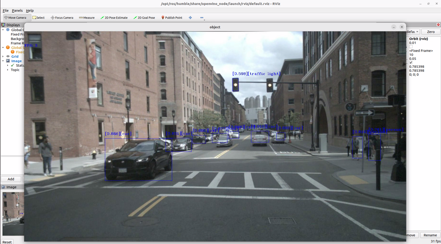

  • Step 5: Run openvino_node in another terminal
ros2 launch openvino_node pipeline_object_topic.launch.py
Result:
